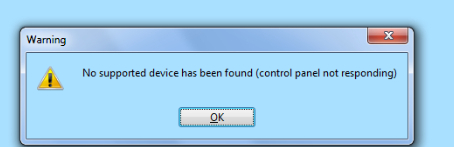

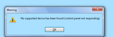

When I try to connect remotely via internet I get the message “No supported device has been found(control panel not responding). Also testing the LAN via DNS TEST remain RED LIGHT.

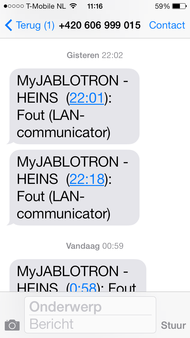

The System has been activated for MY JABLOTRON APP. When I unplug the LAN Cable, I do see a message in the HISTORY of the MY JABLOTRON APP: there is a time stamp with “FAULT LAN communicator. Besides that I receive an SMS message from +420606999015: MyJABLOTRON-HEINS (22:18): FAULT(LAN-communicator). When I plug in again, I get message on My Jablotron app, that LAN fault has been repaired
Also a section alarm is reported in MyJABLOTRON and same SMS message from +420606999015.

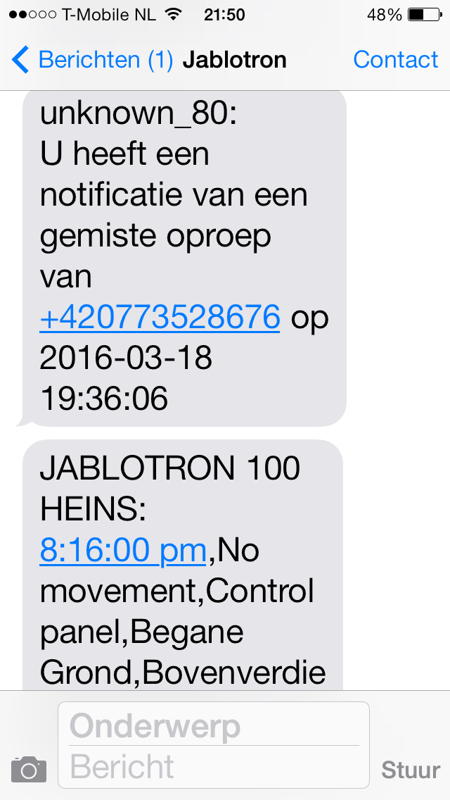

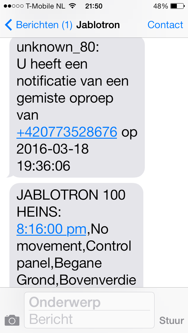

I also get a sms-messge from the panel straight forward with name “unknown_80”, where normally the message starts with JABLOTRON 100 HEINS, which is system name.
