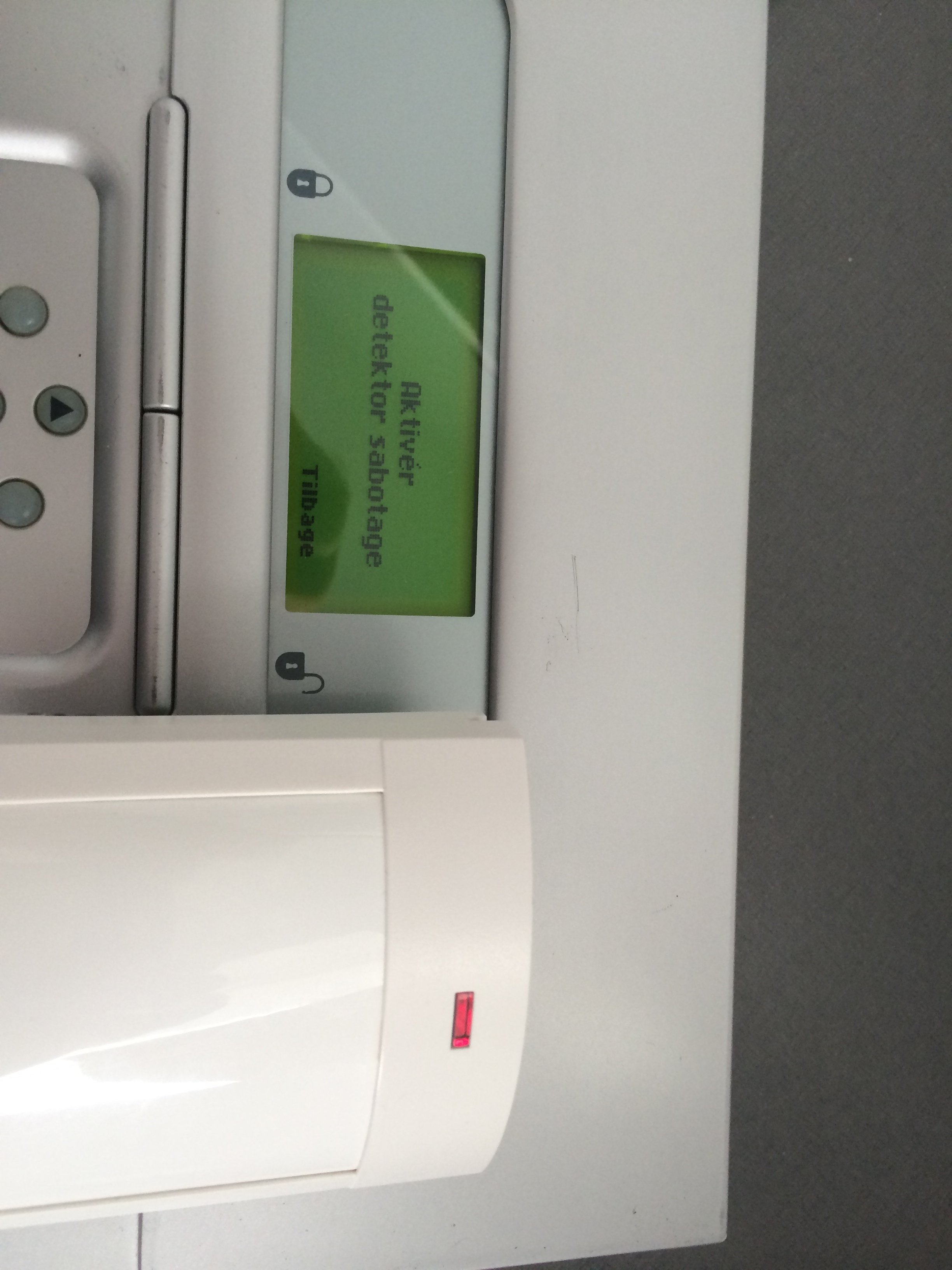

My Scantronic R7500 cannot detect my three Pir 714R sensors?
Jamming is set to off.
The batteries are new.
I activate the sabotage function by opening the lid of the sensor
I have also tried pushing the tamper/sabotage button
What can be the issue.
You can answer in German also :-)

wenn you put the new battery in, ist the red LED blinking?
try to push the sabotage button for a few seconds an several times.
best regards
megagramm
02-08-2014, 10:06
RE: Scantronic R7500 cannot detect PIR 714R?
Yes, led is blinking red. But the R7500 does not detect them, still.
I have tried pushing the sabotage button several time for all three sensors, but no luck.
Best Regards
Roar Slot
02-08-2014, 13:46
try to delete the PIR on your R7500 completly.
Then try again to learn it on your R7500.
best regards
megagramm
03-08-2014, 07:04
That I did from the beginning.
Best Regards
Roar Slot
