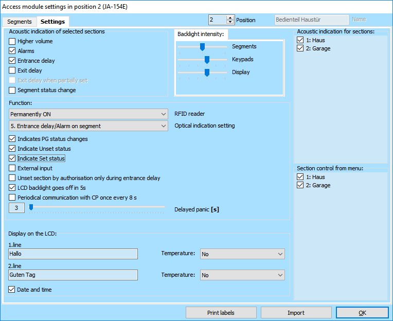

JA154E no light in buttons - MolinoDK - 01-09-2019 14:19 Hi all, I've got my self a brand new JA 100 Alarm, and use a JA154E Panel. I've got 2 zones, appartment, and basement. When i push the white plate to see status on the buttons, only the zone thats disabled is showing green, the basement which is enabled, shows nothing. How do i change this? Right now i am testing wireless, but when i mount the system the panel will get permanent power. I use F-link software. Thanks! RE: JA154E no light in buttons - timbaum - 01-09-2019 17:06 Hello, in the settings of the 154E there is a point called " INDICATES SET STATUS". You have to choose this option. wbr Tim RE: JA154E no light in buttons - MolinoDK - 02-09-2019 18:33 (01-09-2019 17:06)timbaum schrieb: Hello, I cant find that, could you maybe upload a screenshot of the settings? RE: JA154E no light in buttons - timbaum - 02-09-2019 19:26 Hello, here it is. Wbr Tim RE: JA154E no light in buttons - MolinoDK - 02-09-2019 19:29 (02-09-2019 19:26)timbaum schrieb: Hello, Ah, i think i had this settings, i will take a look tomorrow then, thanks! |
